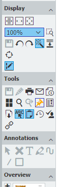

We used to be able to put annotations after a stamp was applied through Document workflows. This is not something that was done too often, but now users are unable to put annotations after the document is stamped. The annotation options are greyed out.
It's not a permissions issue, as this problem persists when using an admin account.
Where is the setting to allow annotations?
