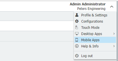

In order for the DocuWare Mobile App to connect to your DocuWare Cloud, you must first establish the connection by specifying the URL of your DocuWare Cloud organization. This way, the app knows which DocuWare Cloud to connect to.
This is done either by scanning the QR code available in your DocuWare Cloud menu "Mobile Apps" (see screenshot) or by manually entering the address (optorg.docuware.cloud).
After that, the DocuWare login screen will appear.
If Single Sign-On is configured and enabled for your DocuWare Cloud, you will see the "Continue with Microsoft" button there.
