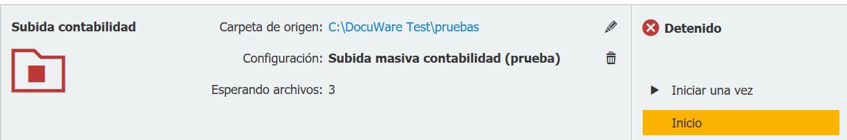

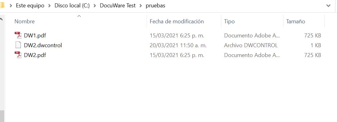

I am following KBA-35471 to the letter, which indicates a process to mass load the documents, for this case I want to do it on the option <by definition in the metadata file> however it always throws an error: below I refer the code and the error.
<ControlStatements xmlns="http://dev.docuware.com/Jobs/Control" xmlns:xsi="http://www.w3.org/2001/XMLSchema-instance">
<Document>
<InsertFile path="C:\Doumentos contailidad\DW2.pdf" />
<InsertFile path="C:\Doumentos contailidad\DW1.pdf" />
</Document>
<Page>
<FileCabinet name="CONTABILIDAD"/>
<Field dbName="EMPRESA" type="Text" value="EMPRESA DE PRUEBA NUMERO 3"/>
<Field dbName="A_O" type="Text" value="2021"/>
<Field dbName="SUBSERIE" type="Text" value="BANCOS"/>
<Field dbName="TIPO_DOCUMENTAL" type="Text" value="EGRESO"/>
</Page>
</ControlStatements>
What other alternative is there? I need to upload more than 20 thousand files massively with 4 indexing fields

Registrato Sun, 28 Mar 2021 13:47:23 GMT di Craig Heintz SE
The xml shown is missing some info.  Here is a sample I use to compare to when troubleshooting this type file.  Keep in mind the order in which you list the documents dictates the order they are clipped in the final document.
<?xml version="1.0" encoding="utf-8"?>
<ControlStatements xmlns:xsi="http://www.w3.org/2001/XMLSchema-instance" xmlns="http://dev.docuware.com/Jobs/Control">
<Document>
<InsertFile path="TestFile1.pdf" />
<InsertFile path="TestFile2.pdf" />
</Document>
<Page>
<Field dbName="DOCTYPE" value="PO" />
<Field dbName="DATE" value="2015-10-12" />
<Field dbName="COMPANY" value="ABC Company" />
<FileCabinet name="Documents"/>
</Page>
