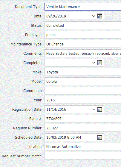

Have created an email notification to go out that sends a Date/Time Index Field as part of the description for the email.   The time appears to be received as the incorrect time on these emails and are 7 hours off in time.  Possible a Time Zone issue?  Please advise on how to correct.   Verified Index field shows correct date/time but email is showing incorrect time.

Thanks for the responses.  I believe Phil Robson's response should do it.  For some reason overlooked that setting and was set incorrectly.
