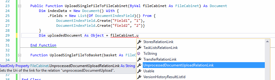

I'm not sure if I'm missing something so simple, but I'm testing the .net api.
I'm able to connect using the sample code.
but for the UploadsingleFileToFileCabinet, there is no function for Upload document in filecabinet:
UploadDocument

It looks like you don't have the extension methods for the FileCabinet object (of which UploadDocument is one).
Did you install all the proper NuGet packages so that your .NET solution has the DocuWare assemblies? That is where the extension methods reside, namely:

Make sure the DocuWare NuGet packages are installed, rebuild your solution, and try again.

投稿済み Thu, 07 Nov 2019 21:08:55 GMT 、投稿者 Raymond Papa
Thanks for the quick reply.
Yes, I think I do, I selected the DocwareWebclientIntegration in Nuget
投稿済み Thu, 07 Nov 2019 21:13:23 GMT 、投稿者 Raymond Papa
I see it now, looks like I was missing something :)
