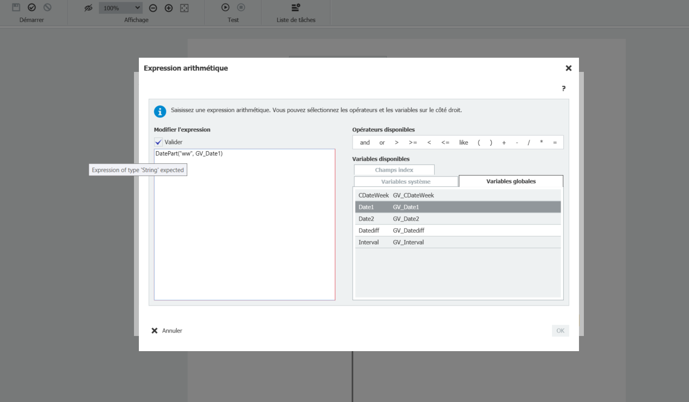

Publicado Thu, 23 Mar 2023 16:15:52 GMT por Vorawooth Quang
Sorry, but I can't manage to make the DatePart function working.
Publicado Fri, 24 Mar 2023 08:17:38 GMT por Gerardo Lisanti Team Leader Product Management
Hi&#160;Vorawooth,<br> <br> you are almost there. The DatePart() function returns a Variant (Integer). That means you can write the returned value to a field/variable of type &quot;numeric&quot; in DocuWare Workflows.<br> <br> I suppose you are trying to write to a field/variable of type &quot;text&quot;. For this you need to convert the returned value to a string using CStr().<br> So the expression looks like this:&#160;<code>CStr(DatePart(&quot;ww&quot;, GV_Date1))</code><br> <br> <br> Viele Grüße / With best regards,<br> --<br> Gerardo Lisanti<br> Product Manager &#160;| &#160;DocuWare GmbH
Publicado Fri, 24 Mar 2023 08:34:41 GMT por Vorawooth Quang
Hi Gerardo,<br> <br> Thank you for your help! It works perfectly now.&#160;
