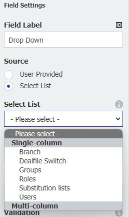

Publicado Tue, 12 Jul 2022 08:33:00 GMT por Stephen Murray IT Manager
Hi Michael,
Many thanks for your reply.
How do I setup a multi column select in the form? When I click to select that option, there is nothing below it. See attached.
Thanks, Stephen

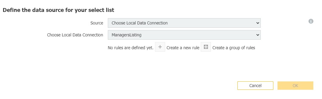

Publicado Thu, 14 Jul 2022 11:14:24 GMT por Stephen Murray IT Manager
OK, so I am slowly working my way through this.
I have now setup a local data connector to the DB with our managers list in it.
Then in Docuware, I have gone in to indexing assistant to add the new connection.
Once I have selected the local data source and connection, I am left with a message at the bottom which says:
No rules are defined yet.Create a new ruleCreate a group of rules
I can only then click on 'Cancel'.
Where do I create the rules? Does this need to be done before setting up the indexing assistant?
Thanks, Stephen

Publicado Thu, 14 Jul 2022 11:52:53 GMT por Stephen Murray IT Manager
Hi Simon,
Those buttons are greyed out, as per attached screen shot.
Publicado Thu, 14 Jul 2022 13:18:25 GMT por Simon H. Hellmann Toshiba Tec Germany Imaging Systems GmbH IT-Consultant Document Management Solutions
Hi Stephen,&nbsp;<br> <br> there is something wrong with your Local Data Connection. Below "ManagersListing" there should be a box where you can select which columns of the data source you want to use for your select list.<br> <br> <br> Greetings from Germany,<br> Simon H. Hellmann<br> DocuWare System Consultant
