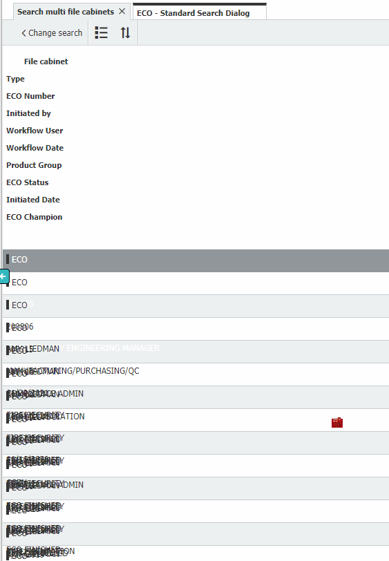

Several users are experiencing showing one column in doc trays and view lists.  The documents over shadow each other and can't figure out which document is which.  Does not appear to be browser specific.

Publié Mon, 25 Jan 2021 16:05:57 GMT par Martin Zebedies Uriot GmbH & Co. KG Head of Solution Consulting
Have you tried to move the bar from the right side to the middle?
it looks like the viewer basketview is max width?
