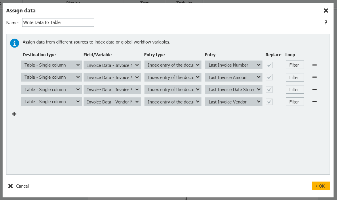

According to what I read here ;https://docuware.uservoice.com/forums/230570-client-english/suggestions/38934235-include-the-ability-to-write-to-table-fields-autom. we should be able to load table fields automatically in a workflow using the Assign Data activity. I have tried it to no avail. The configuration looks correct and there are no errors or faults in the workflow. The table is simply not written to and the document history for this step simply says "Variable is empty"

Hi Steve,
according to your configuration the workflow will loop through the rows of the destination table and add the specified values to the selected columns. Maybe you can explain a little what you are trying to achieve and I can help to find a solution.

Registrato Mon, 02 Jan 2023 20:06:53 GMT di Steve Shriver Application Specialist
Thanks Simon and Gerado for your comments. Here is what I am trying to accomplish:
A Purchase Order Document is on file in the PO File cabinet. When an Invoice is added to the Invoice File Cabinet with a PO Number field that is not empty, an AutoIndex job is triggered which finds the matching PO number in the PO File Cabinet and updates the 'Last Vendor Name', 'Last Invoice Amount',' Last Invoice Number' and 'Last Invoice Store Date' field of the PO document. This triggers a workflow on that document that updates the 'Remaining Amount' field of the PO document with some simple math. There is a table field also in the PO Document with 4 columns. I want to capture the 'Last Invoice Amount', Last Invoice Number' etc. fields from the PO Document fields and update the columns in this table so I will have a history of all of the invoices added to the Invoice File Cabinet that posted against this PO document when viewing this PO. The PO document is a DocuWare Form submitted by the requesting user and at the time of submission the table field is empty.

Registrato Mon, 02 Jan 2023 20:33:51 GMT di Steve Shriver Application Specialist
Some further testing has shown this: If I prefill the table with one row of data, the workflow will populate the table with the data I want, overwriting the prefilled row. When a second invoice is stored it will update the table, but will again overwrite the first row. I have the filter set to 'is not empty'. If I change the filter to 'is empty' it will not write any data.
What I would like to do is add a new row for the second and all subsequent invoices. Also, there does not seem to be anyway to prefill the table row/columns when using a form.

Registrato Tue, 03 Jan 2023 08:48:22 GMT di Simon H. Hellmann Toshiba Tec Germany Imaging Systems GmbH IT-Consultant Document Management Solutions
Hi Steve,
thanks for the detailed description.
@Gerardo: Yes, I forgot about this feature to add rows.
However, this seems to be exactly the use case for adding new rows which is currently not possible.
As far as I understand, Steve wants to add a new row to a table of the PO each time an invoice related to the PO is stored. To my knowledge, up until DW 7.7 this is not possible without using the .NET/REST API.
Registrato Tue, 03 Jan 2023 12:04:28 GMT di Gerardo Lisanti Team Leader Product Management
Hi Steve,
I understand. At the moment you can add table rows only when you transfer data from one table to another.
There you can only map table columns to table columns, e.g.
  • '[MyTable]Last Vendor Name' = '[MyOtherTable]Last Vendor Name'
  • '[MyTable]Last Invoice Amount' = '[MyOtherTable]Last Invoice Amount','
The missing piece is the assignment of index fields to table columns, e.g. like in your case:
  • '[MyTable]Last Vendor Name' = 'Last Vendor Name'
  • '[MyTable]Last Invoice Amount' = 'Last Invoice Amount'
We will look at that and see if we can improve things in the future.
Currently we are working on improving and extending the mapping of data between 2 tables by being able to match rows.
Product Manager  |  DocuWare GmbH
Registrato Tue, 03 Jan 2023 14:42:45 GMT di Steve Shriver Application Specialist
Thank you Simon and Gerado. You are correct. I need to add a new row to the existing table for each new invoice. Looks like I need to wait for version 7.8 or maybe 7.9. Unfortunately I'm too old to learn to code it myself :)
