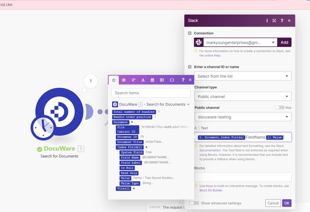

Can anyone give me guidance on pulling index data with the DocuWare module in make.com? I am trying to put the contents of an index field into a Slack text message but can't figure out what block or code to drop into the text editor. The attached picture represents my best guess but it is not working.

I think the question was already answered by the support case, but for everyone else looking for the answer I want to describe it here.
There are two possibilities to get the index entries <ol> <li>
  • Use the index number of the field.
    So, first look up in the DocuWare module the index fields, that you want and then enter this number instead of your "FieldName" entry.
    Look at screen "Index number"
  • Use the map functionality with the index field name
    Again, first look into the DocuWare module and check the exact field name and tehn use the map functionality in Make.
    See screen "Map"
