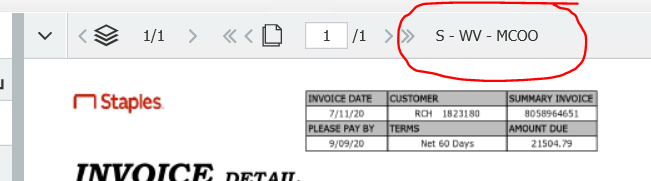

After upgrading to v7.3 a user has noticed/complained, that the value displayed at the top of the viewer pane is no longer correct. It was the field marked as the document name in the database fields of the file cabinet configuration. It now seems to be the document name from the document tray.
Is there a way to control this displayed value?
See image...

Depends if you are talking about the viewer from the Document tray or the viewer from the file cabinet
What I see from a 7.3 is :
From the document tray the value displayed is the DocID
From the File Cabinet the value if the field marked as the document name.
It might depend also which was the original version number (before update)
Gilles

It appears that from the Document Tray the Name of the document in the tray is used.
From the file cabinet the name of the image file itself is used. So in my case "Scan Inbox - 001". Which is useless.
I renamed it in the tray before storing, and then that name was used in both cases.
In any case, the field designated as the 'Document Name' in the database fields configuration is NOT used. Which, I believe, would be much better, allowing us to control it.
Has this been changed in v7.3 purposefully? Can it be modified?

My build is 7.0.3.55801. In every case it seems to be the file name.
See the images for examples
