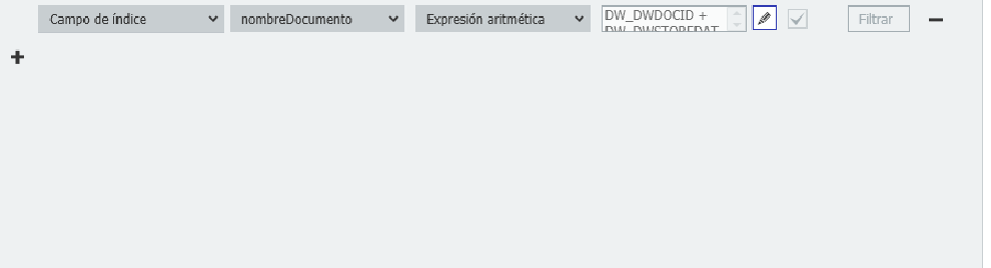

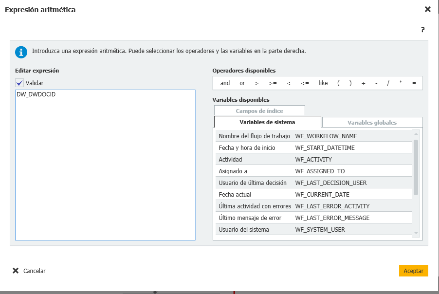

Posted Tue, 27 Feb 2024 16:08:25 GMT by Emmanuel Jimenez Support Engienner
Of course you can modified file name, this are the steps to follow:
1.- in Cabinet select a field to name the file
2.- Create a workflow or add an activity to a existing one, in this activity you need to add the values to rename the file (image 2 and 3)
3.-Save and publish the workflow.
If you follow tthe steps once that you download-send the file name has changed, in my case i rename it with doc id
Posted Wed, 28 Feb 2024 09:16:23 GMT by Mélanie Mélanie
Thanks for your help. Indeed, I have made the same thing as you did. It modifies the index as well as the file name when the file is downloaded. But it does not modify the file name which appears in the file viewer. Did you manage this ?
Thanks again,
