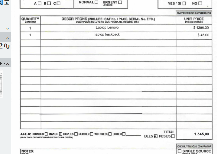

When setting up a form, I’m struggling to choose between Web Form and Merge Form since both have their pros and cons. I’m wondering if I’m missing a configuration option or if these limitations are inherent to the product. Attached actual exported files for your reference.

To address the issues above, I tried using a Merge Form, and it worked well for my needs. However, I ran into one major obstacle:
  • After submission, Table Field values don’t appear in the exported Merge Form file (no matter PDF, Word, or Excel).
    Is Table Field designed merely to be collecting the data into entries? or how Table Field should be used in Merge Form?
