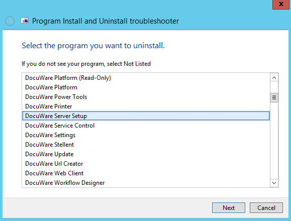

Posted Wed, 13 Mar 2019 20:41:32 GMT by Matthew Trembly Software Support Manager
Run the Microsoft Install/Uninstall repair troubleshooter: https://support.microsoft.com/en-us/help/17588/windows-fix-problems-that-block-programs-being-installed-or-removed
Download and run the Fixit for "Uninstalling" and remove any DocuWare items that are still there after the uninstall (see pic for how they will appear).
